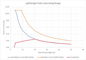

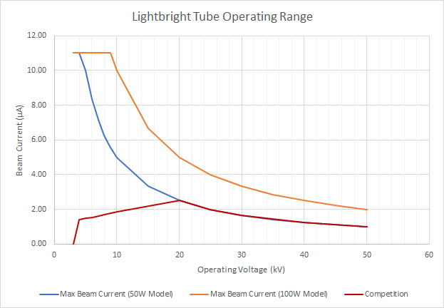

For XRF applications that demand low energy operation, our Lightbright tube can deliver. It has been designed with a robust filament and a high extraction electron gun that can support continuous operation up to 11mA all the way down to 3kV excitation voltage.
Compared to a competitor’s tube, the Lightbright can deliver many times more flux at the lowest excitation voltages, without sacrificing tube life. This groundbreaking beam current capability, combined with the Lightbright’s end window design to minimize source to object distance, means that for light element XRF, there’s no better tube on the market.
