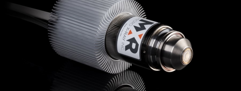

Lightbright End Window Tube: Maximizing Precision
The Lightbright end window tube, designed for precision and efficiency, features a large cone angle an ideal takeoff angle to maximize usable flux. Ultra-thin window options, as thin as 50μm, reduce low energy absorption, capturing even the subtlest spectral lines. Its end window geometry facilitates close source/sample/detector arrangements, optimizing detection efficiency. Integrated o-ring grooves support helium or vacuum purge capabilities, maintaining spectral purity and minimizing background noise.

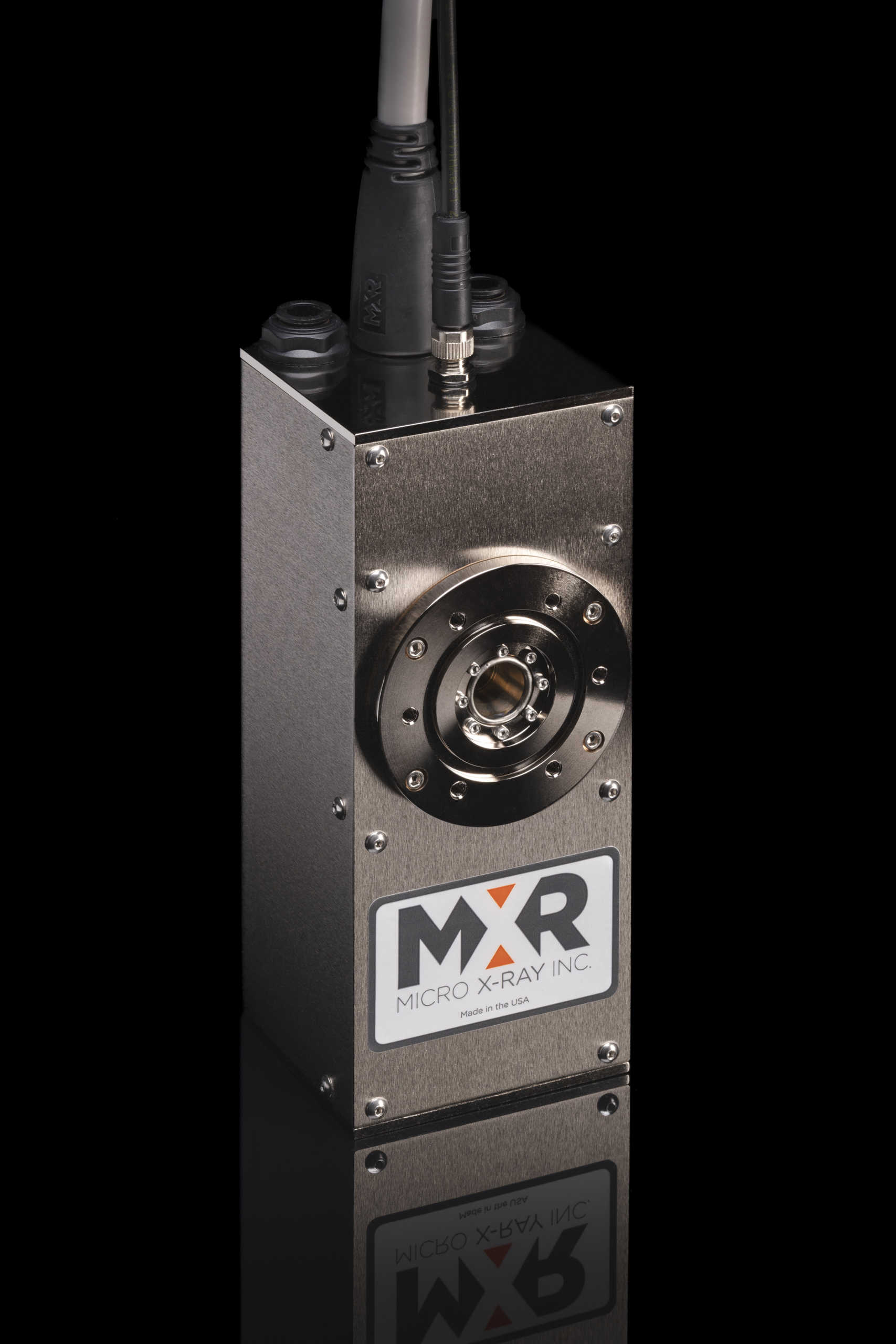

Mini-Focus Packaged Tube: Redefining Versatility and Reliability
Our mini-focus packaged tube has been designed with an industry-standard form factor, allowing for easy drop-in replacements in both laboratory and field settings. Thanks to a proprietary oil filling technique, it can be mounted in any orientation without arcing, ensuring consistent performance. The integration of a high voltage (HV) cable reduces failure risks by removing the high voltage well connection point, enhancing device reliability and enabling quick and easy maintenance.
