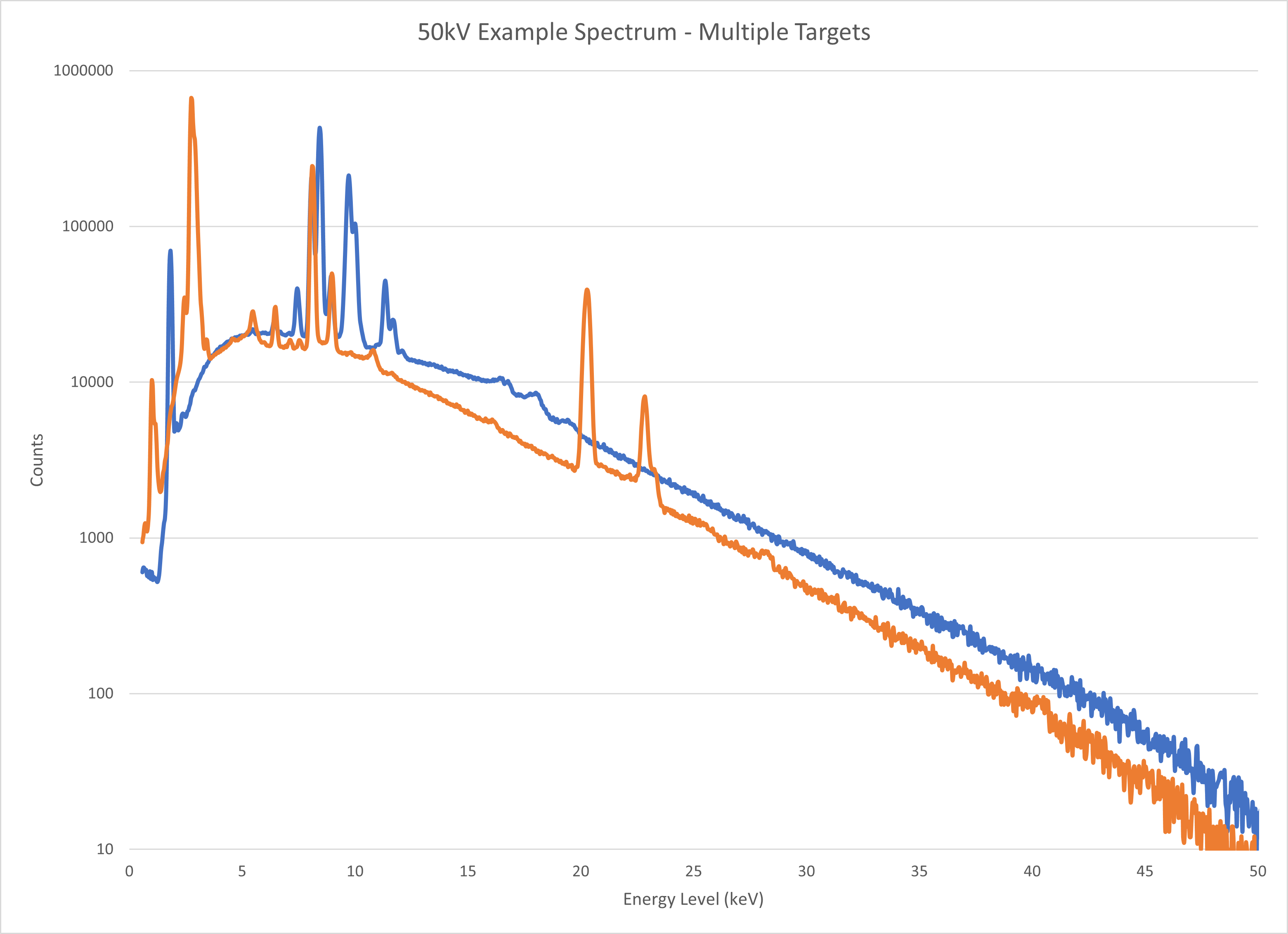

In the chart above, we can see spectra from two different X-ray tubes with different target materials. These are same X-ray tube type, run at the same excitation voltage (50kV), the same beam current, and the same acquisition time, and the same detection system. Neither spectrum is inherently better or more useful for XRF than the other; depending on the elements we are trying to analyze, the peaks around 20keV in the orange spectrum may be useful, or in other cases the higher bremsstrahlung shown in the blue spectrum may be more beneficial.
